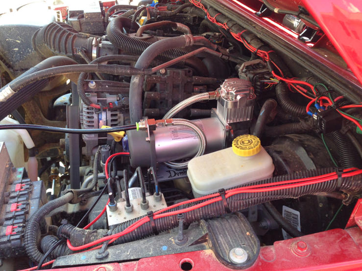

Simple answer, yes. If you wire it with a switch as you stated it will run until you turn the switch off. Viair's site has a wiring diagram to do exactly that. That being said, the chuck you would mount at the bumper can not be the normal type you use at home that seals with nothing connected or the compressor will run and continue to build pressure until something blows. The hose kit they sell works well.
I do not run a tank but I pieced together parts to have mine run until it pressurizes then shuts off. I got a distribution block, pressure switch, pop off, gauge etc and ran ran lines to where I permanently mounted the couplers. I found everything I needed by looking around the web. There are some good diagrams on viair's site. Try jeepswag (vendor here).

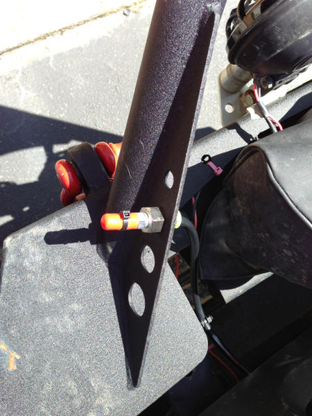

Running a Viair 400h, wired thru a relay to a switch on the dash, Dominion Offroad bracket, and bumper mounted air coupler. It's a kit from Jeepswag that he was running as a members special on in the vendors forum
