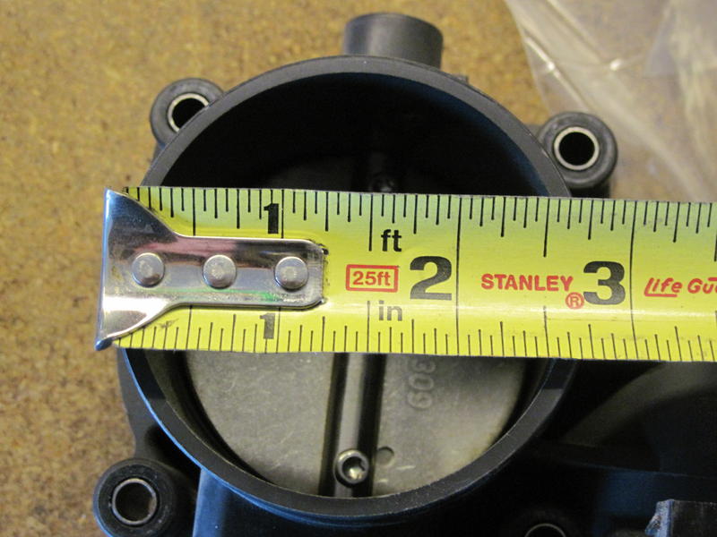

Hey guys, I just installed a Viper throttle body on my 07 JK. First observations are throttle response is definitely way up and the motor tacks up in rpm a lot faster. Cruising rpm on the highway also appears less resticted. No problems or warning lights and it bolts right up. It is almost a solid 1/2 bigger in diameter. The stock one looks really small next to the Viper one.
It is a noticeable improvement, but don't expect 20 hp out of it. Overall, I am happy with the purchase.
Mopar part # 53032837AB got mine for only $135 bucks!!!

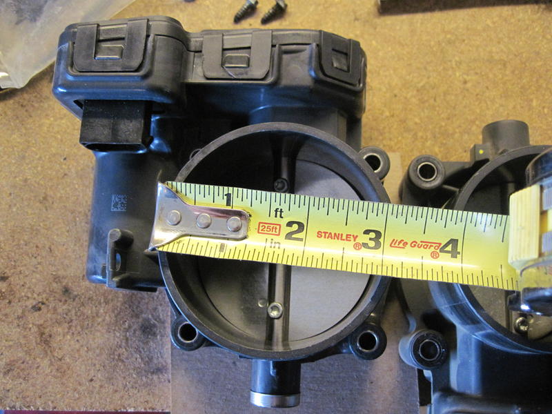

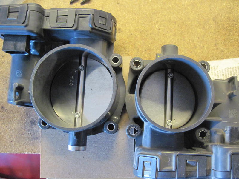

Will do. Here is a couple of pics with a tape measure showing the difference. Viper TB is 3 inchs and stock is only 2.5 inchs.
