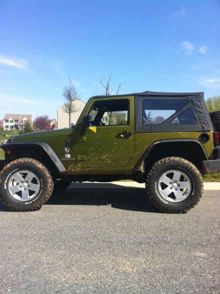

I have a 2dr sahara. I have the Tera Flex 2.5 BB with shocks, Rubi Unlimited 4dr springs (gave me and extra 1" in the front and 1.3" in the rear), modded stock flat fenders and a Rough Country 1.25" body lift on 37" KM2's (really about 36.2"). If you have aftermarket rims wider than 8" I would go with a Toyo or MTR as they are closer to stated size.
Here's a shot with the 35's and 37's. I personally think it is a great look, just like with the 35's, just bigger (same amount of space in the wheel wells).
