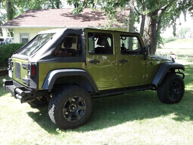

This is a bad choice if you're looking for mpgs :(
I suggest an all terrain 285 for commuting. The E rating bfg gives a pretty stiff ride that you might not enjoy on your long commute. Michigan roads are horrible. I'm on mobile so i cant see your location. If you have good roads, you might be ok with an E tire.
Maybe find some cheap rims and keep those 315s for when you wanna take it out and play with it.
The bgf all terrain 285 measures 32.8 if i remember correctly. I highly recommend this tire, but there are lots of options available to you... really just a matter of what you want to spend and what you want to do.
If you're budget is an issue, like mine is, check out the Treadwright Warden. Same tread pattern as the bfg all terrain, but they are retreads. From what ive read, they are safe and reliable, and nearly half the cost. You could buy 5 of these for less than 4 bfgs, and have money left over for a second set of rims. I sold my factory 17s for $250 with tires mounted. Here in Michigan there are always take-offs available (yay AEV)
Personally i like the gap between my fenders and my 285s. I think my skyjacker 2.5" springs actually net closer to 3.5" of lift, even on my jku.
I keep meaning to/wanting to get a hypertec flashpaq, but again with the budget... so i cant really speak to its gains and benefits.

That's the tire I been thinking on getting but as u I'm on a budget tires cost way to much money it's insane

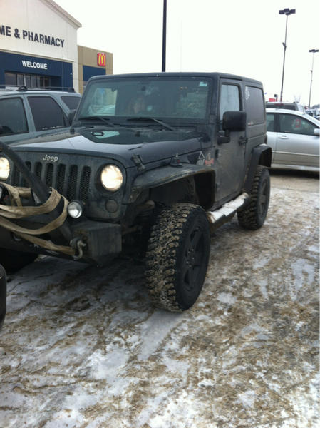

So I got rubicon tires and they look so tiny but I like getting 18.5 mpg now haha I may get 285's some day but I'm gonna run these till there bald

Yup the BFG m/t's
