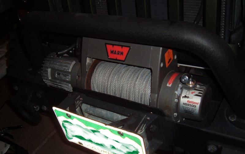

Old Jan 8, 2015 | 01:21 PM
nthinuf's Avatar
Posts: 11,463
Likes: 165
15 years and still going strong, but I really need to get around to yanking this thing and cleaning it up...
The parts diagram is on their website. I still have the paper copy of the manual, but haven't seen it online.
http://www.warn.com/truck/Replacemen...srrpl37-38.pdf

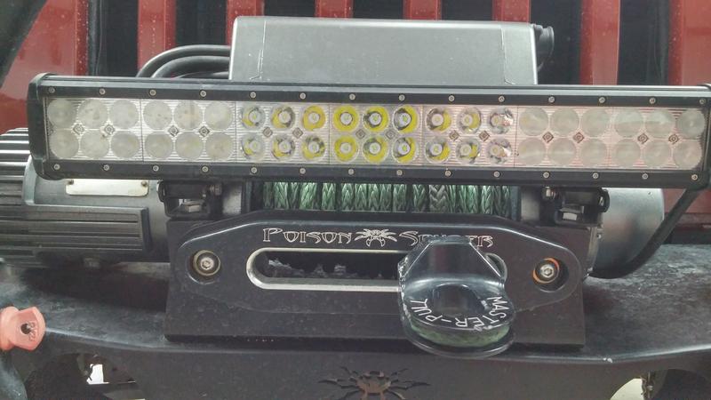

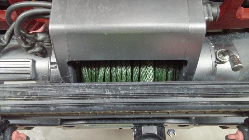

Old Jan 8, 2015 | 03:11 PM
Tim08JK's Avatar
Joined: Dec 2014
Posts: 37
From: Phoenix, AZ
The winch was handed down to me and its still going strong! Here are a couple of pictures...
ID:	591132   Click image for larger version
