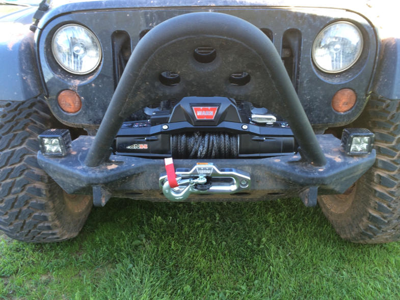

I had the zeon 8s on my last jeep. Had some issues mounting it to my src stinger bumper but was nothing a little bit of trimming couldn't fix.
New jeep came with a warn 9.5ti on it and will be switching for my zeon 8s at some point just because I prefer the look of it
