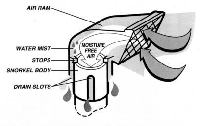

If your using the Ram air. its designed to allow water to flow through it but not into the snorkel
Whoa. That's cool!! Yes I have a ram air. Real happy it does that!
