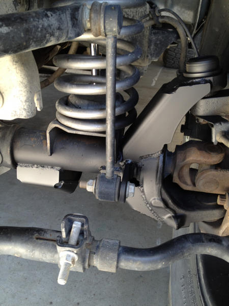

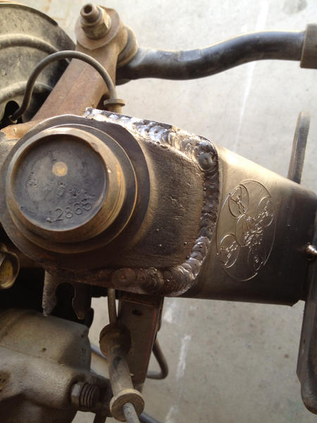

I did mine this past week.
ID:	321198   Click image for larger version

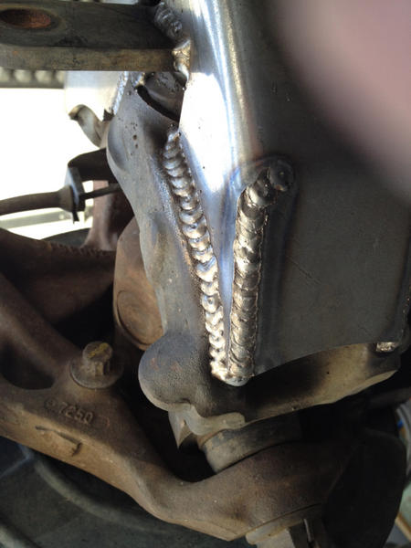

Just do it.
ID:	321201   Click image for larger version
