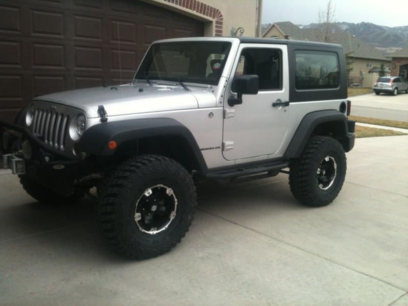

I have the black rock vipers and love them. no problems with brakes.
my wheels have the same offset as yours. they should be ok!

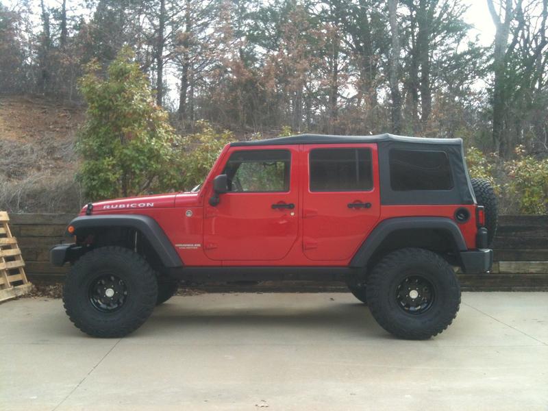

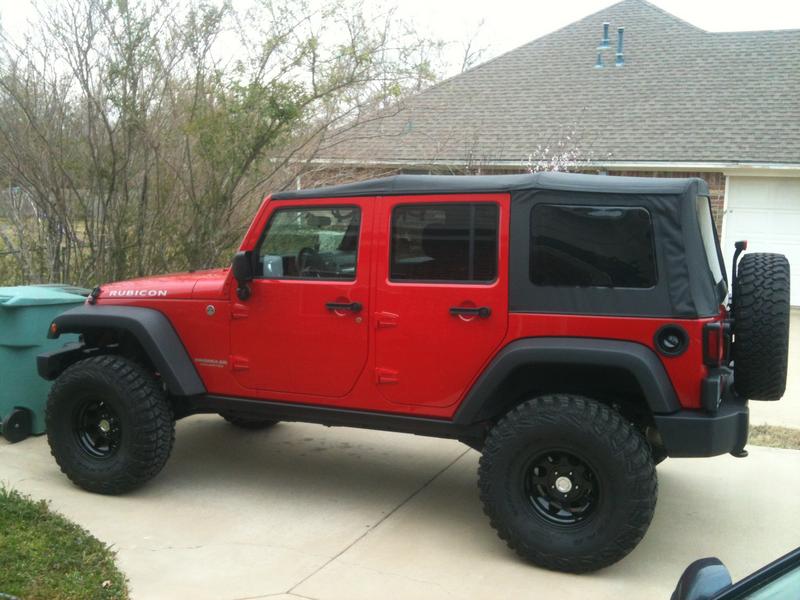

I run pro comp series 98 w/ 3.75 in backspacing. Guys at 4 wheel parts said that they wouldn't fit. Did a lot of reading on here and saw that they fit and proved the guy wrong

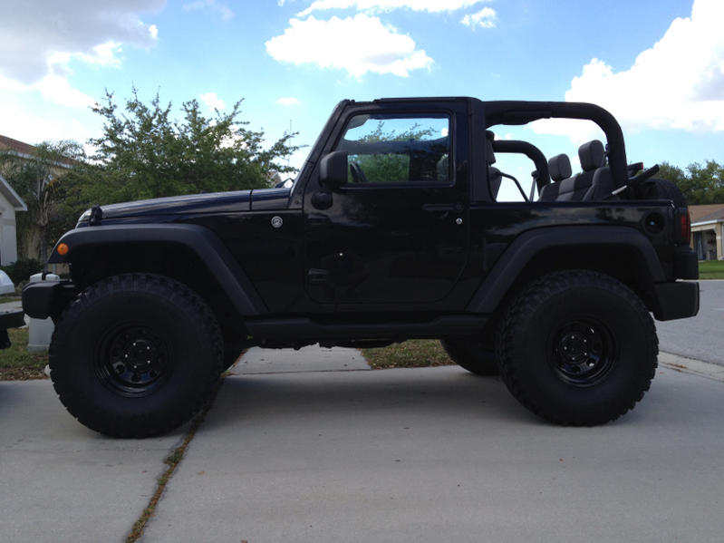

Running Procomp 8069s on my '12. You just have to be careful with balancing weight placement. Don't double stack them and mount them as close to the face of the wheel as possible and you should be good to go.
