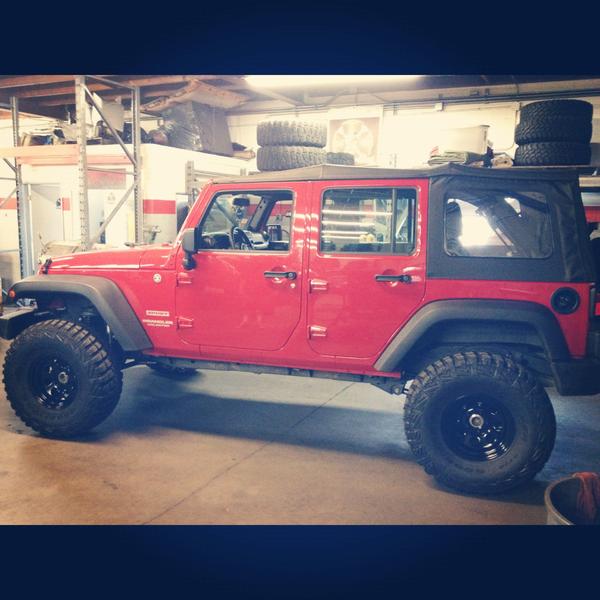

15" Cragar Soft 8s, I had to use wheel spacers to clear the caliper.
They were like 60 bucks a piece from Jegs, and they look sweet on my Jeep.
Tires are 35x12.50R15 Goodyear MTR
