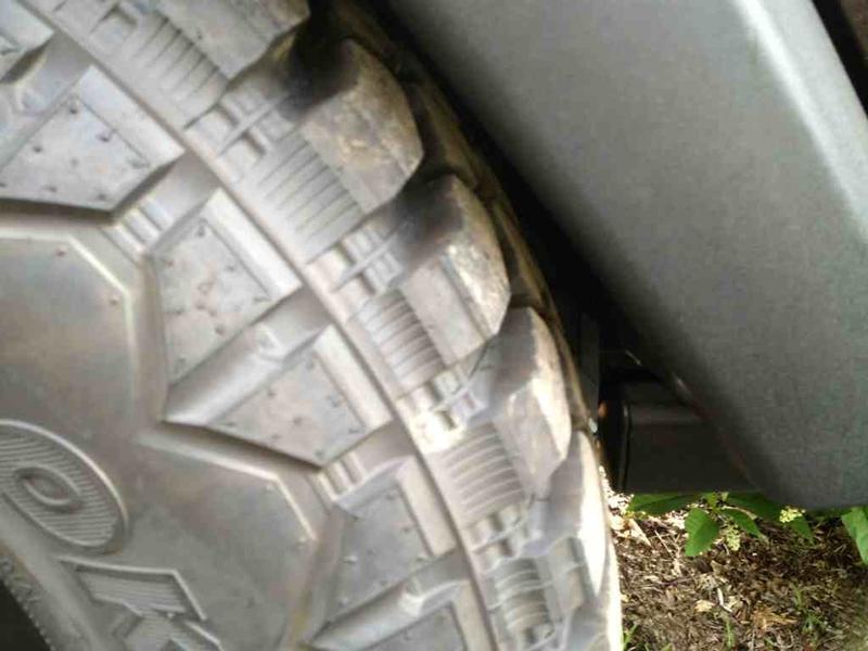

Stuffed with 35's Click image for larger version
What else is included with that kit? 4" is opening a can of worms if not done correctly.
