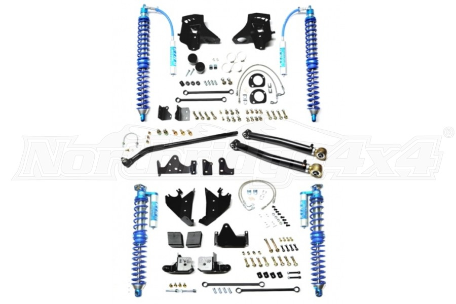

Just checking to make sure I have this right.
This is the lift you're talking about and its contents?
https://www.northridge4x4.com/part/c...on-kit-stage-1
It seems to me with 37's and that height, you would likely want replacement rear control arms to re-center your rear axle to avoid rub. Unless there's some brackets in that kit that I'm missing which extends the length of the rear control arms?
That seems like a lot of money for that lift where the only thing I'm seeing special are the coil-over shocks and a bunch of extension bracketry.
