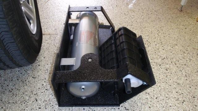

Im liking the way this river raider setup is. It relocates protects and gives you access for an airtank all while using the factory bolt holes. Id love to see a write up or at least theinstructions for instalation.

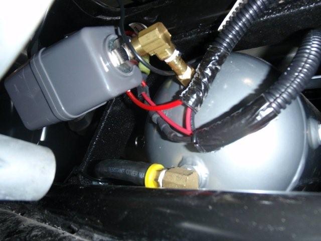

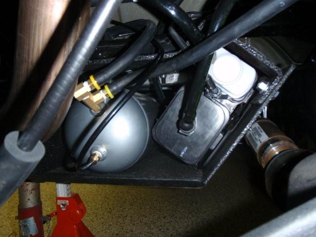

Here are a few picture of the River Raider set up. I think that it should work well.
