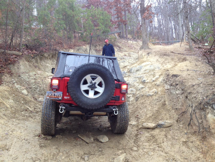

I've never needed my spare but I'd feel naked without it. I've seen 35s mounted to the stock carriers last for ages when the tire is isolated well. I've also seen them fail when they weren't. I couldn't get mine to matchup with my tire/wheel combo so I bought the Bestop oversized carrier for $200, Smitty has the same carrier cheaper. I'm currently carrying a 37 on it now. It carried a 35 for two years prior.

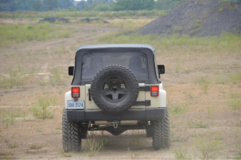

i have had mine mounted since August 2012 with no issues. It weighs 130 lbs.
Actually, the only issue I have, is my wife seems to think she needs to literally slam the gate shut, every F'n time she is in there.......
