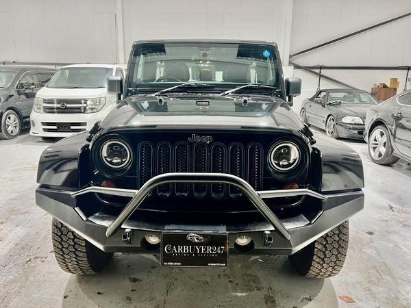

My first question is does anyone know what front bumper this is? I want to see if there's a similar aftermarket rear available.
I'm in the US and was considering the Rough Country flat fender flare kit because I much prefer the look compared to the painted fenders. But I think it could look off given how wide the aftermarket front bumper is!

Welcome to the Forum. no idea on that bumper .. agree with your thoughts on flat fenders..

Welcome to the forum. You can shorten the bumper to go with the flat fenders. Just requires cutting to where you want and add, on both ends, a piece of 3/8" plate cut, fitted and welded. Kind of looks Smittybilt ish. Recommend you go for the 285/75/17 tires as they are 34" and with the lift you won't have rubbing issues but you may have to correct the caster a bit.
