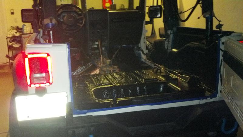

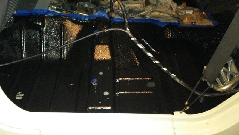

monstalined the tub. Used brake cleaner to partially dissolve the sound deadener, than it took a gasket scraper and wire brush to bring it down to bare metal.
