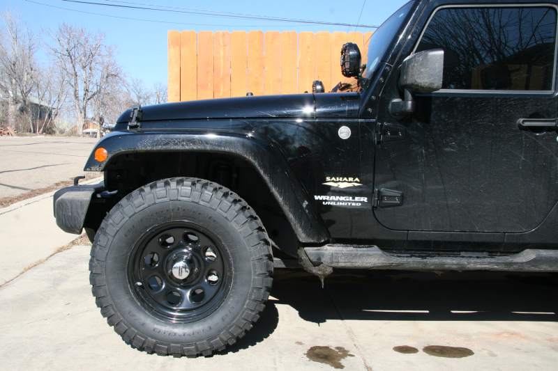

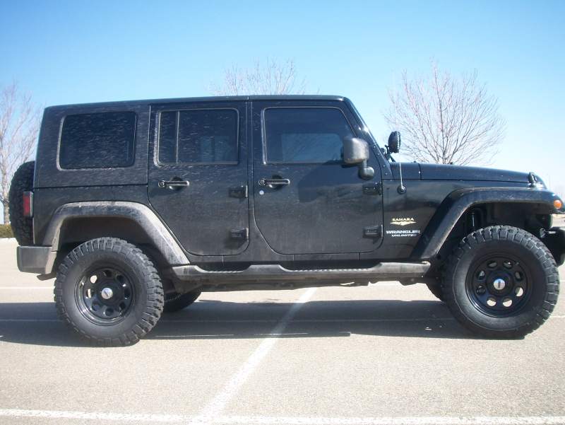

Here are my 17x8 Soft 8s with 4.5" bs...the tires are BFG M/T TA KM2s in size 285/70R17. I love 'em...kinda wish I had a little less wheel, but the KM2s don't fit 16" rims unless you go up to 35s...
Before lift:
Here's a pic after TF BB:
