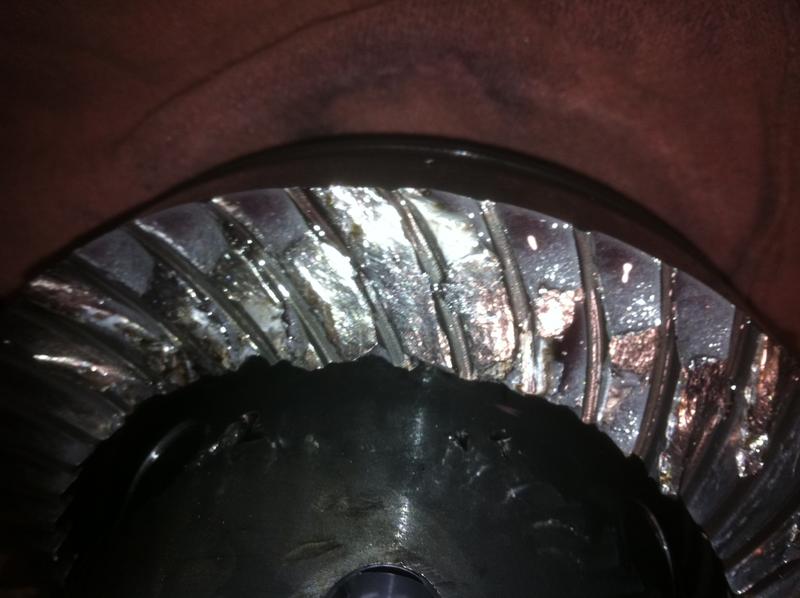

My opinion?
You have a D30 front. Going to higher (numeric) gears makes the already small r&p a lot smaller and weaker. Then you add alloys and a full locker. And you end up with something a little like this:
Another question is, would it be cheaper to swap out the front D-30 axle before doing all the mods to upgrade it?? which is cheaper, cost of the mods, or replacing with something stronger??
Add up all the costs involved in building your current axle, take into account how you plan to use it, and then decide if you are better off throwing the money away or upgrading to a PR...
To be fair, a lot of people are running locked 30's and having no issues at all. But a lot of other guys are bending and shattering their axles with on-road driving. Roll the dice...
