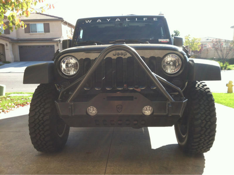

Just did my JCR last night. 4 coats of rustoleum light grey primer, and 3 coats of rustoleum black hammered.
