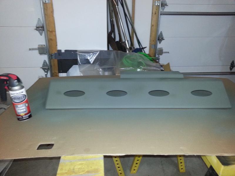

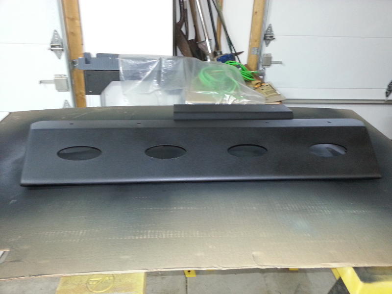

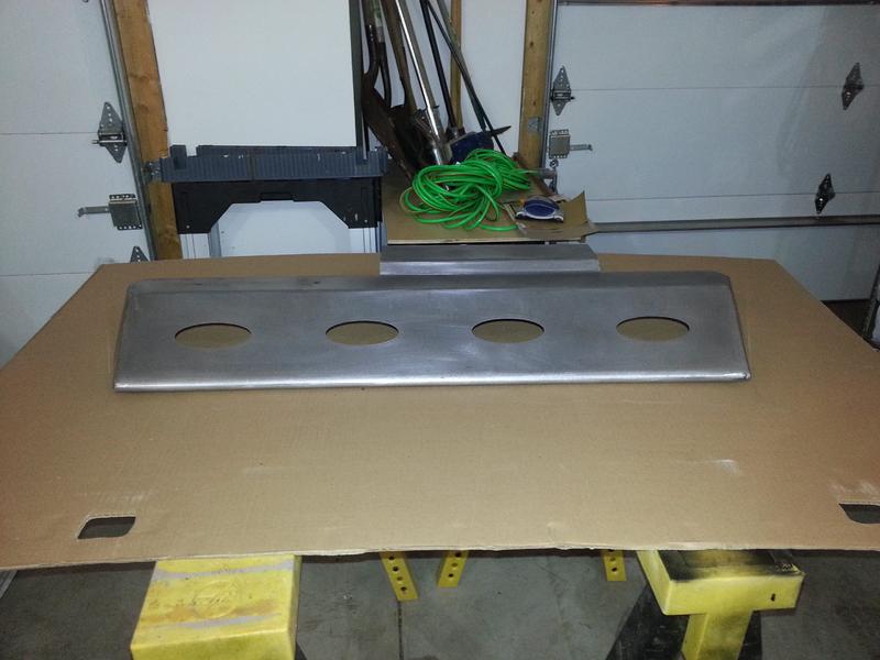

Here are some shots of my prep/paint on my PSC Brawler Skid (my bumper didn't arrive they accidentally shipped it to the wrong state).
My process was:
  1. I general cleaned the skid plate
  2. Sanded with 400 grit sandpaper
  3. Note - based upon my results I would suggest sanding with 80 grit paper
  4. Cleaned with mineral spirits
  5. Applied three coats of Rustoleum Self Etching Primer
  6. Note - did not sand between because I like the gritty texture
  7. Applied three coats of Rustoleum Truck Bedliner
Hope this helps anything thinking about their coatings.
