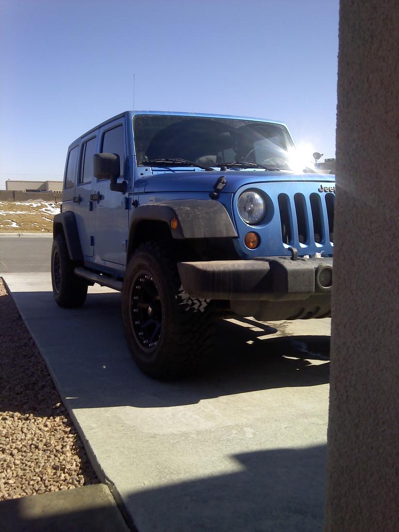

Here are the pics you asked for. Hope this helps.

Looks good but you have a lift and bigger tires,they seem to stick out quite a bit,maybe because of the tires.
