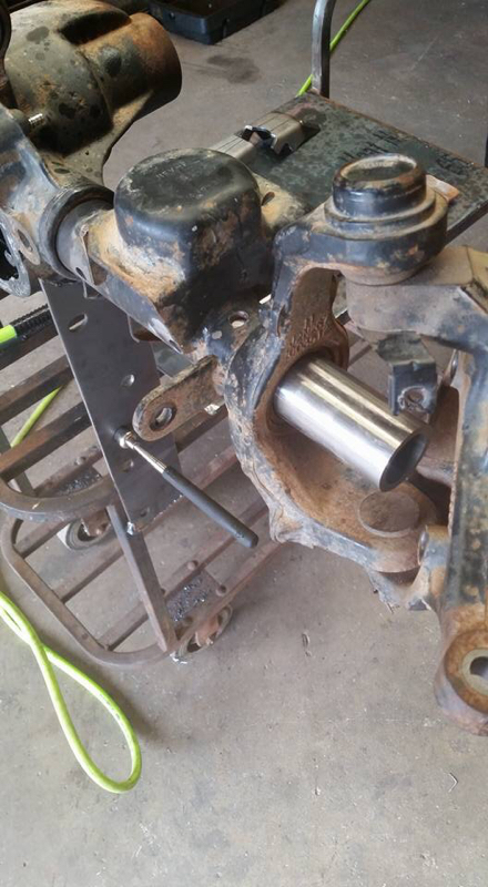

man may as well have sleeves installed while doing the gussets. I had mine re-geared and c's gusseted, have to take it all apart anyway. Might as well. Cost me 400$ for the synergy gussets, sleeves, and lower control arm slides parts and welded.
