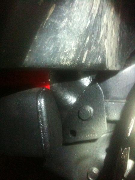

TRIM!!! Peace of mind.... Check, extra clearance..... Check, and not to mention when you air down and roll up on a rock your 1/8 gap is now a 1/8 or more cut. Cut the seam with a angle grinder, no need to weld. Cut the slider( if rubicon) with a metal table saw to keep the heat down and paint touchups minimal.... My 2cents

I certainly don't want anyone to think I'm telling them what to, just want to share what I did as a result of experience. Basically, I aired down to 12, and rolled up a ramp.... No problem, but!!!! When i rolled up onto a 16 inch tree stump, the tire flexed above the stump and started to rub on the stock rock slider. And of course cutting the slider meant cutting the pinch seam.... Again , my 2cents but I hope this is a little more descriptive,and hope it helps
