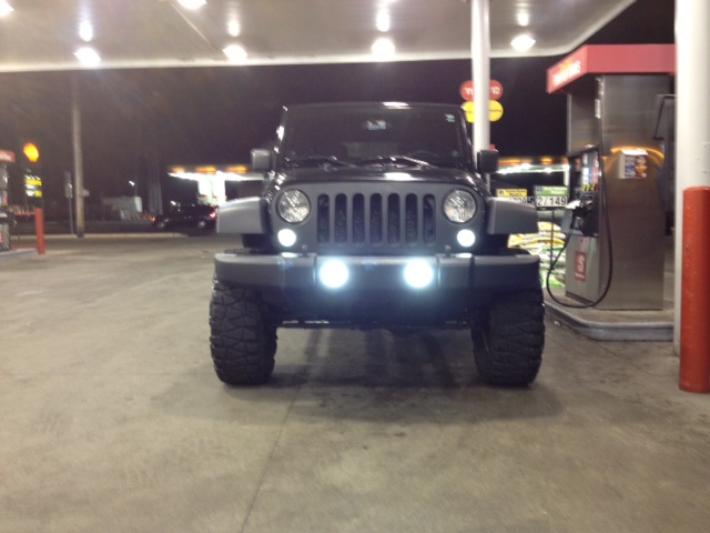

I have about 20 hrs on my Rough Country's. Click image for larger version
