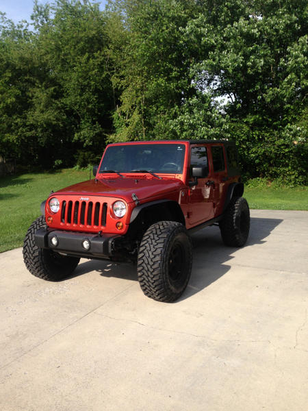

Went with 1.5in spacers from Poison Spyder. Trimmed the pinch seem some and everything works fine on 3in of lift
