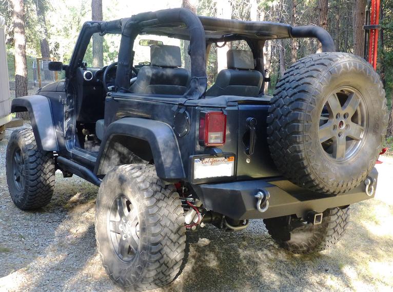

1.75" on my 07. Still get some minor rubbing at full turn on my LCA's

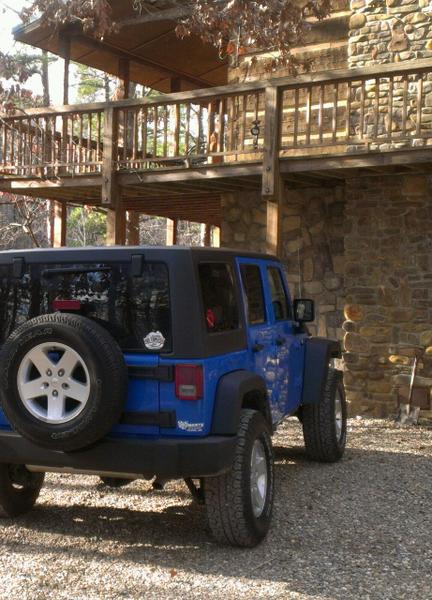

1.5 inch spacers.

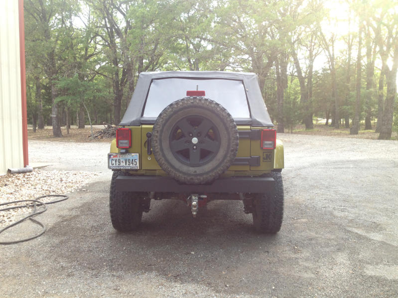

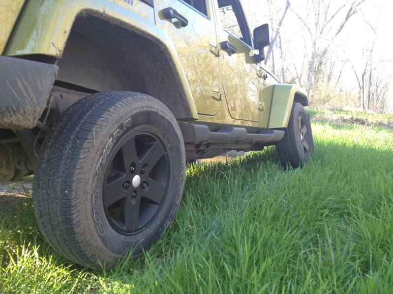

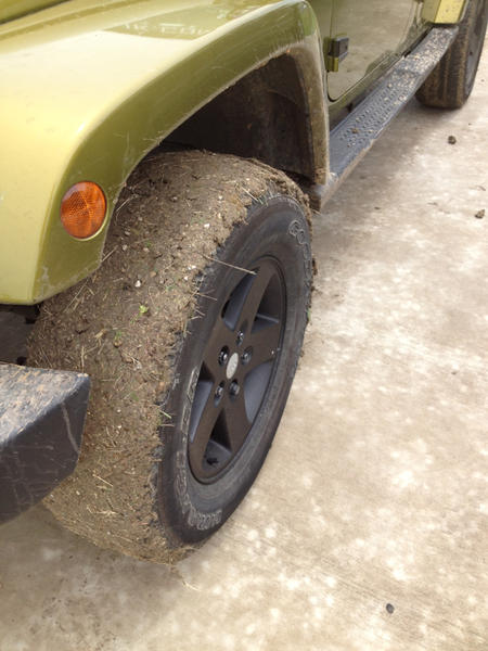

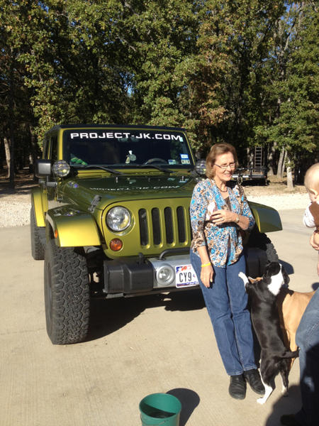

Rough Country 1.5" wheel spacers. I got them for $118 for all 4 shipped to my door.
I've been running mine for 30k miles and over a year.
Here's pictures of mine, all are with the spacers.

I've ran mine about 35000mi now with no problems.

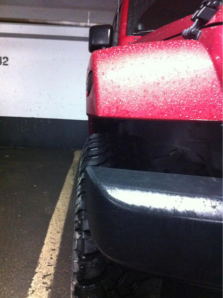

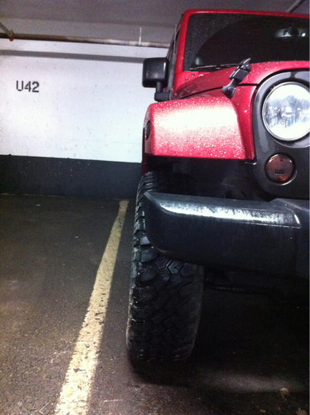

1.5" spidertrax with stock Rubi wheels. Sticks the wheels out so they are just at the edge of the fender. Love the look and makes the jeep feel more stable with my 2.5" budget boost. Just make sure you remove the retainer rings from the wheel studs and use red loctite and you'll have no problems.
