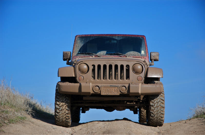

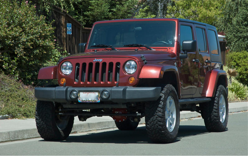

Welcome to the jeep world. Buy quality spacers: I used 1.5" Spidertrax for 4 years and about 90,000 miles with 275x70x18 Cooper STTs. That makes a skinny 33 or ~33x11x18; it ran flush to the fender. So a 12.5" would go past the fenders. Not all shops will mount a 12.5" tire on the stock 7.5" rims, although it works well. Just follow the instructions with the spacers, use locktite, torque, recheck torque and make sure you remove the lock washers on all of the studs.
No lift street use & flat fenders = 35's
No lift & dirt = 33's ( may have minor rubbing )
Pics are with a 2.5" Teraflex coil and shock kit.
