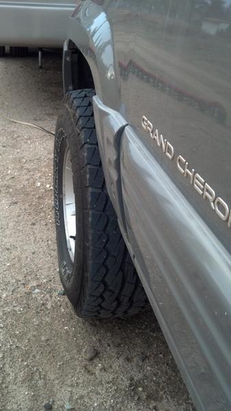

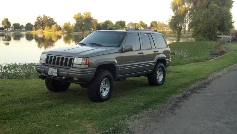

I did! I bought a set about 2 years ago for my '98 ZJ and had no problems with them. They were pretty good quality, CNC machined aluminum. The most important thing is to to torque them properly and make sure they don't loosen up or move. I ran them for about a year and a half for around 11,000 miles - on and off road.

ok, thanks for the help and onfo.

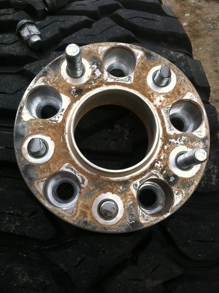

I did too.... and mine had weak studs! Broke a few off torquing them down after a few rotations.

I dont know. But here's a pic, looks as though a couple studs were slightly cracked before breaking
Attachment 586703
I'll sell you these if you want some cheap spacers! LOL
No, thanks.....so it seems to me they are going cheap on the grade of thread material? Was there anything wrong with the hub?
No, the hub was perfect. I almost just upgraded the studs, but I got a great deal on the spidertrax spacers, so these are sitting in my garage.
