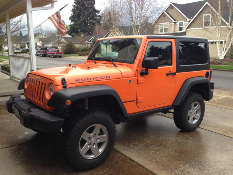

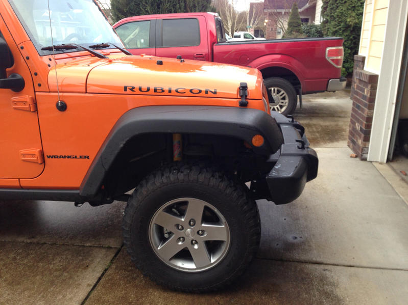

When I got it I was thinking I was going to put 33s on it. I've changed my mind I'm going to go 35s. I would like to put the 35s on my stock rims. I'm pretty sure that I will need spacers to do that. Is this a bad idea? Is there anything else that I'm not seeing that will need to do.

Its perfectly fine. I have a 3.25 lift with stock tons on 315/70R17 and I wheel it often.

Yeah you're good to go. I also have 315's on 1.5 spacers that see regular abuse and hold up great.

I have been using the Spidertrax spacers for a few years with my 35s without any problems.
I had to use them because with the OEM 17in Rubi wheels the tires were rubbing on the frame. If you change the OEM rims for a model with adequate backspace the spacers will not be needed.

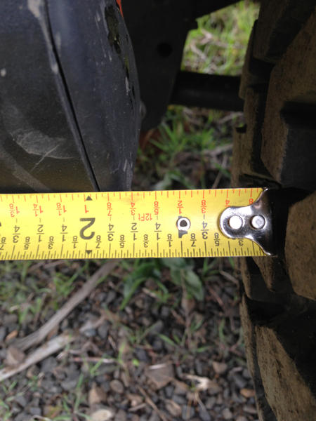

I want 35s but I am not see how it is possible. I have the OEM tires and wheels 31s. I was under the belief that if I got this lift I could do 35s and that was a big selling point.
Old Mar 20, 2013 | 06:42 PM
cg07sut's Avatar
Joined: Dec 2008
Posts: 304
From: SB, OH
12jkb, you are going to have to trim the rail and probably the pinch weld behind it

That is what I was afraid of.
