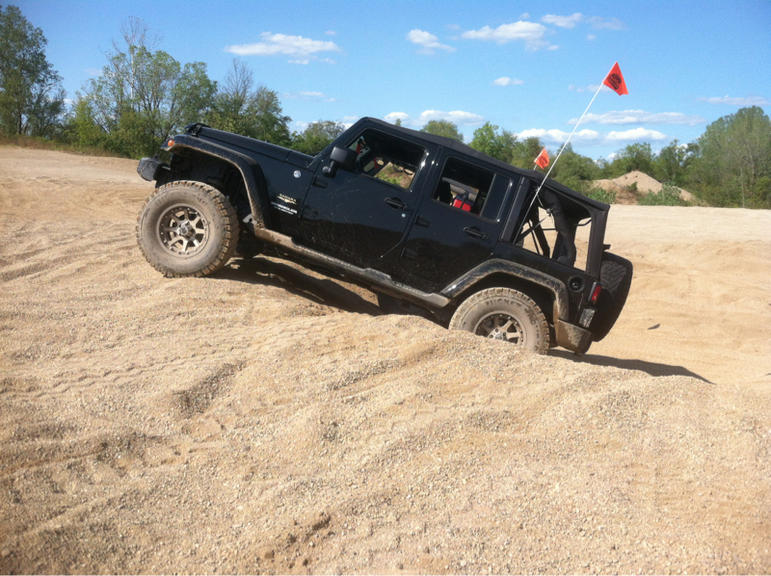

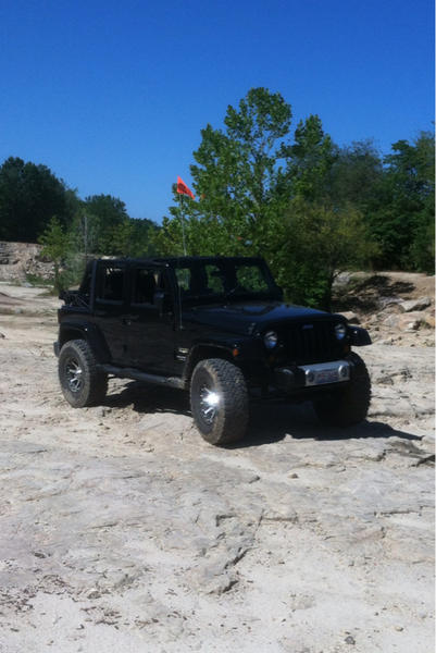

Hey guys looking for some advice here. Recently put teraflex 2.5in lift, 35x12.50x17 Mickey Thompson baja ATZ and xd addict 17x9 on my 12 JKU. Everything is awesome and love it on and off road.
The problem is at about 50 miles per hour the steering wheel wobbles a lot. It goes away at 60mph. I have had the tires balanced 2x at discount tire trying to fix the wobble but hasn't gone away. Everything appears to be tight underneath and don't see any damage and haven't hit anything. Just mild offroading and flexing at local off road parks.
Is this common with the larger and heavier tires? What are you guys doing to resolve this? Thanks!! Here's pics for fun;
