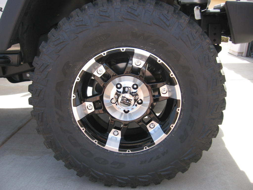

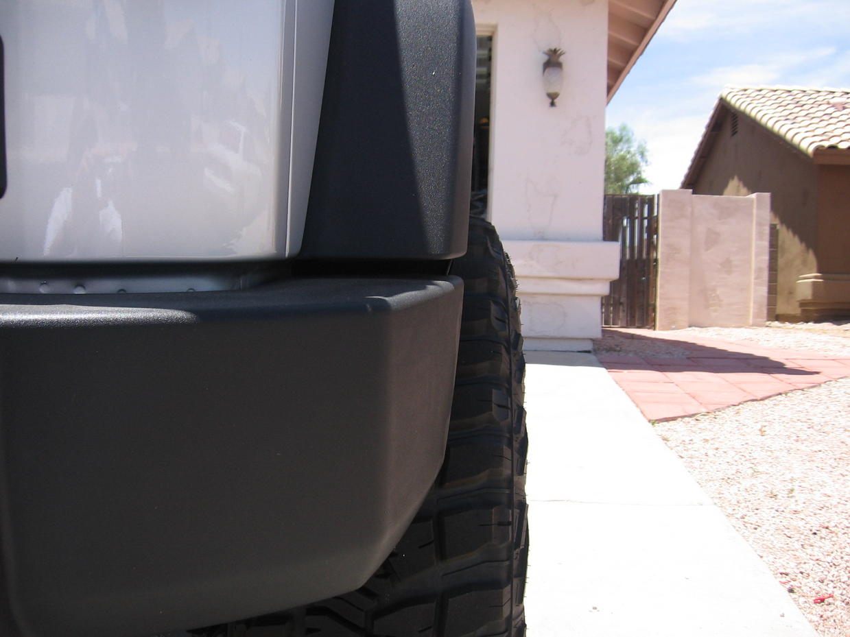

I have the MTR Kevlar 35 with XD spy 17x9 on a Teraflex 2.5 coil lift. Looks perfect!!! You will be really happy with the 17x9. No rubbing at all!!!

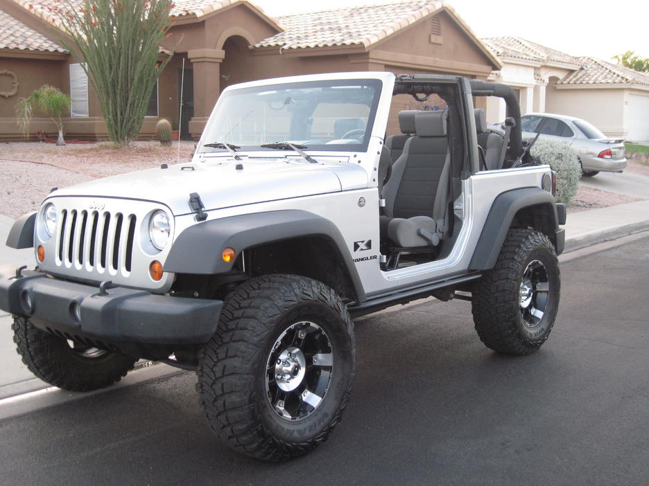

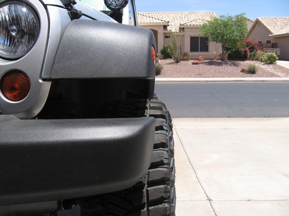

Here's some more pics.

Also, the 17x9 with -12 offset is 4.52 in backspacing and the perfect amout to keep the rear swaybar links mounted on the outside and avoid rubbing the inner fenders on the front when turning.

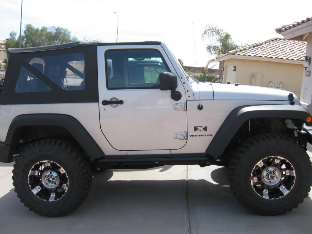

Here is some sideview pics.
