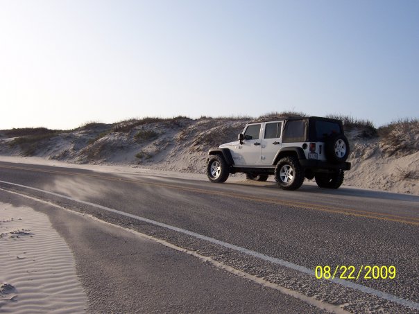

Old Aug 30, 2009 | 11:34 AM
USA450R's Avatar
Joined: Jul 2007
Posts: 245
From: Round Rock, TX

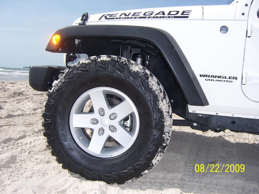

Old Aug 30, 2009 | 11:42 AM
USA450R's Avatar
Joined: Jul 2007
Posts: 245
Better pic of front
No rub but I have 1.5" spaces too.......
