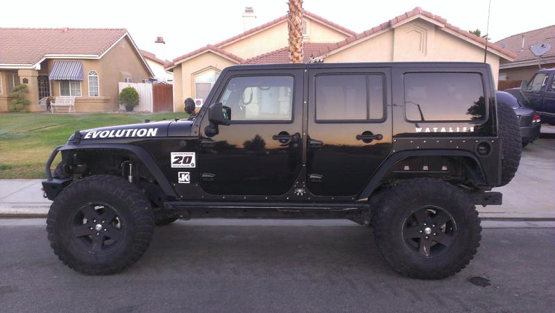

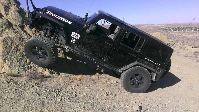

I had a body lift on my jeep for a while. When I first got the jeep last year I installed a TF 2.5" lift and a week later I was going to buy 35" bfg km2's for $1800 out the door mounted and balanced. Then I found some 37" km2's on here for sale for $1000 for all 5. 2k miles on 4 of them and 0 miles on the spare. So I.bought them.and also bought a RC 1.25" body lift. I ran it like this for a while without any rubbing.
Since then I ditched.the front tf springs cuz they sagged a lot and.replaced them with RK springs and bilstein shocks for a 4" lift upfront and 2" lift in the rear
Here's my jeep with 2.5" lift and 1.25" body lift

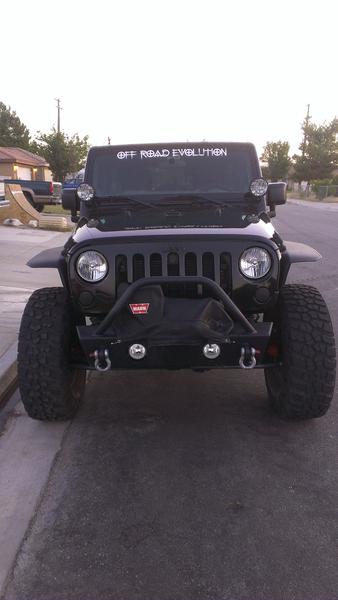

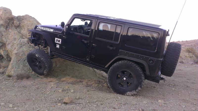

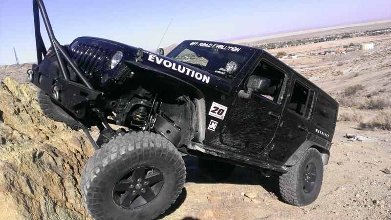

Here's it is with the same lift, no body lift and some a lot more pinch seam trimming.
I still have the same up and down travel up front too...4" up and 7" down, no rubbing

So I pretty much got the body lift just to clear the 37's cuz last year when I was a newbie and didnt know much until I joined this forum. Now I can sell my body lift to someone who needs/wants it cuz I ended up having a more heavier finger on the sawzall. Lol
