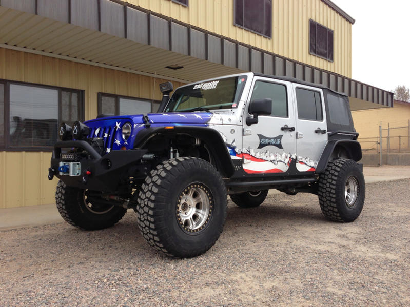

Originally Posted by stlfan06
Because if you happen to take water in your intake, it's about a $4,000 repair.
Ditto.
