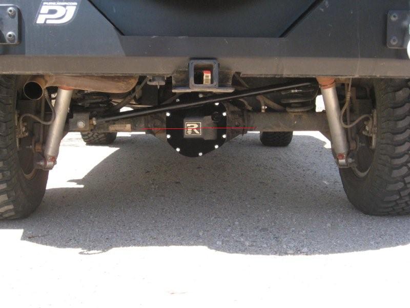

I believe its very slightly less than stock. Proper level for diff fluid and 1/2 way up the axle tube. I use a small zip tie.
1/2 way up the axle tube is a bit of overfill. It should just be over the top of the bottom of the axle tube. Look where the stock fill hole is and you'll see what I mean. Or, use the zip tie dip stick and fill to here:
Name:	Riddler Rear with fill line.jpg

Thanks! Actually, I did not literally fill it up half way, more like 35 to 40% of the tube height. I have a sleeved front axle so I assumed I needed a little bit over the normal amount for the oil to clear the thicker inner tubes but I could be wrong on that.
From the picture I would think the normal amount is about 25% of the axle height, is that right?
see what I mean. ...
That's exactly what Torn and I did when changing my covers a couple weeks ago.
The stock filler hole places the top of the fluid as shown in that annotated image.
With the Riddlers, the fill hole was low enough that I was just able to use the tip
of my pinky to check the fluid heights (D30 front, D44 rear).
