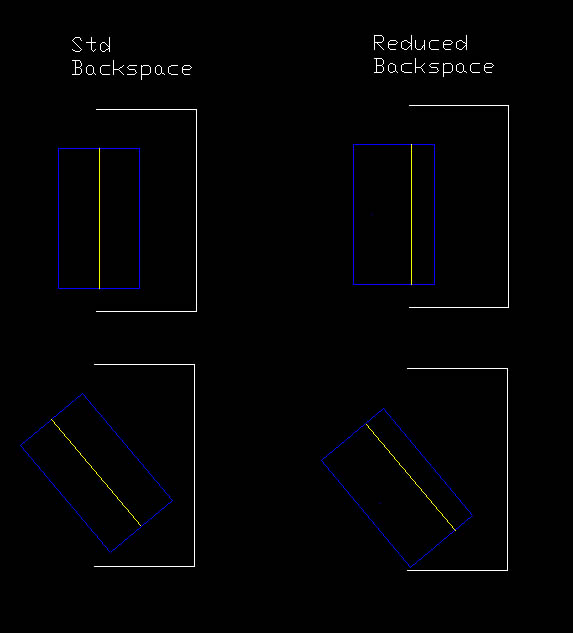

Spacers or reduced backspace wheels (same effect) will help with rubbing on the frame or control arms, but will actually make it worse on the firewall or edge of the front bumper.
This is kinda counter intuitive. See pic.
