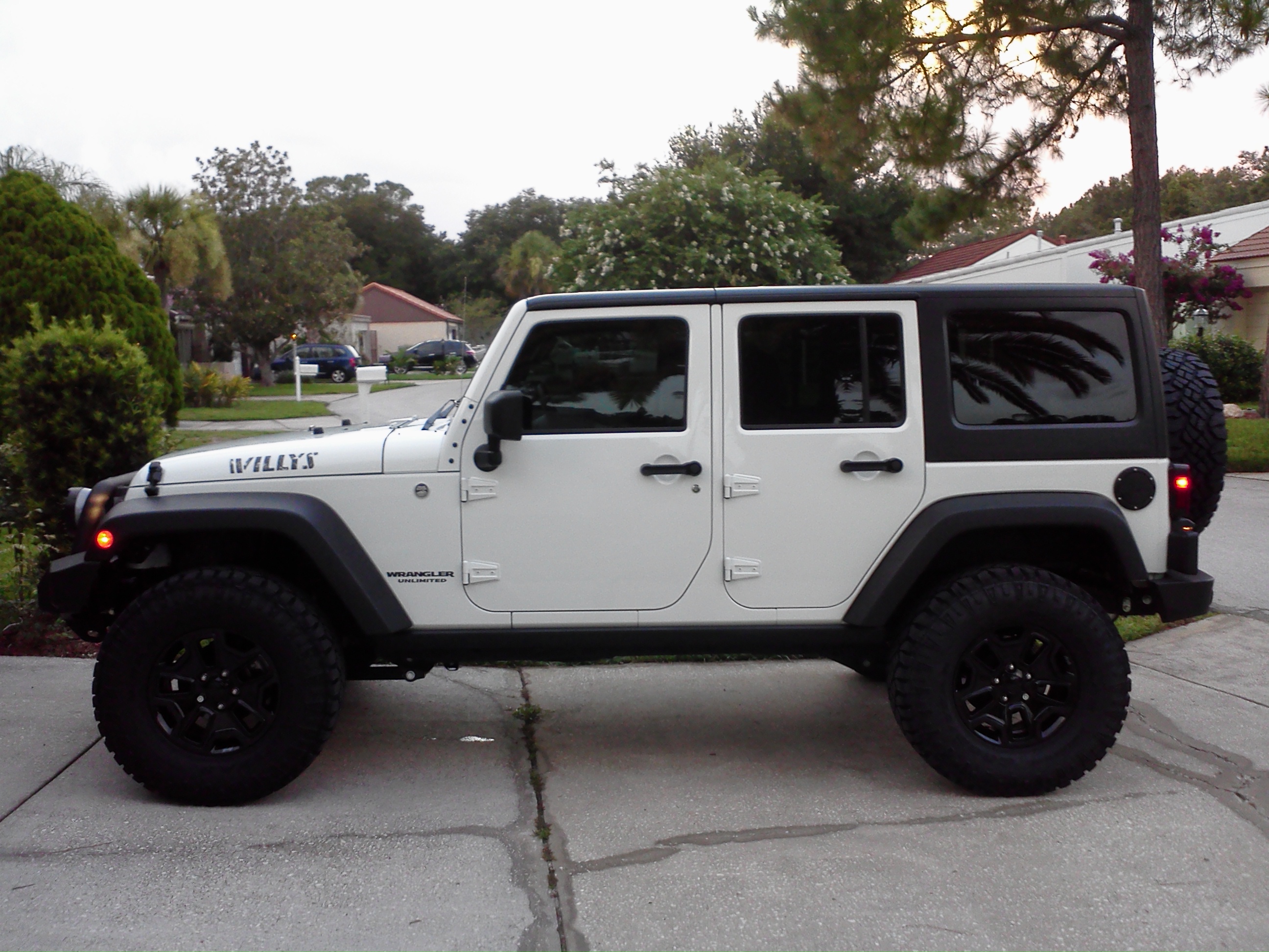

WillysWheeler's Avatar
Joined: Jan 2014
Posts: 78
From: Winter Haven, FL
If you do not trim the Factory Rock Rails they will rub. I installed the AEV 2.5" DualSport XT Suspension and Goodyear Wrangler DuraTrac 315/70/R17 Tires and I trimmed 1.0" off each rail and had no issues off-roading. I also trimmed a friend's Rock Rails off his Rubicon and he running BDS 3.5" Lift and MT APZ P3 315/70/R17 Tires. The easiest way to trim Rock Rails is use a metal blade in Compound Miter Saw and you will need Blue Locktite to reinstall the Rock Rail bolts/nuts. Also need masking tape and Rust-Oleum Flat Black Spray Paint to touch up the end of the Rock Rails after cuttimg them.
