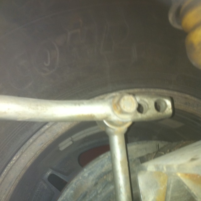

We have three adjustment points so you can decide on how stiff you want the new sway bar.
The product description hits it dead on
Full-Traction now offers a replacement 19mm rear sway bar for use on Jeep JK models that are equipped with a lift kit or used while heavily loaded. The new bar is a bolt-in replacement for the stock bar. It provides increased roll stiffness through its larger diameter and is designed to reduce understeer/bodyroll while still being flexible enough for severe off road use. Recommended for all lifts of 3" and over. Comes complete with urethane pivot bushings and complete installation instructions.

How do the adjustment points work? There is something you can turn to adjust? Can I reuse the stock links on your sway bar?

There's three holes on the side of the sway bar, it works on leverage, the closer to the bar the stiffer the sway bar will be. I have my two door on the stiffest setting.
