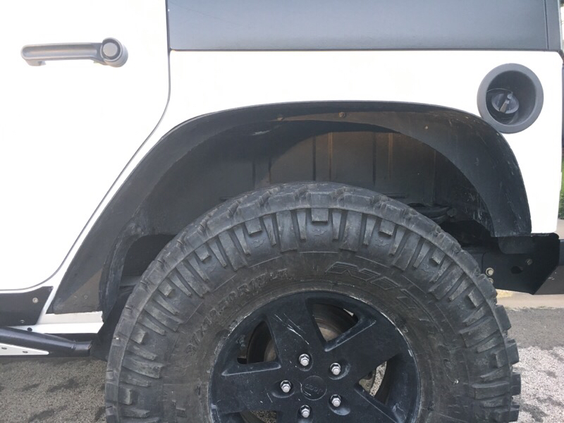

Here's one of my pics from that thread. 37x12.5r17
Did you have to do anything up front to fit those in terms of still having some up travel and being able to turn?
1.75" wheel spacers for stock wheels. No trimming up front I will rub the fender tab but it doesn't hurt anything. Kind of like ghetto bumpstops lol
