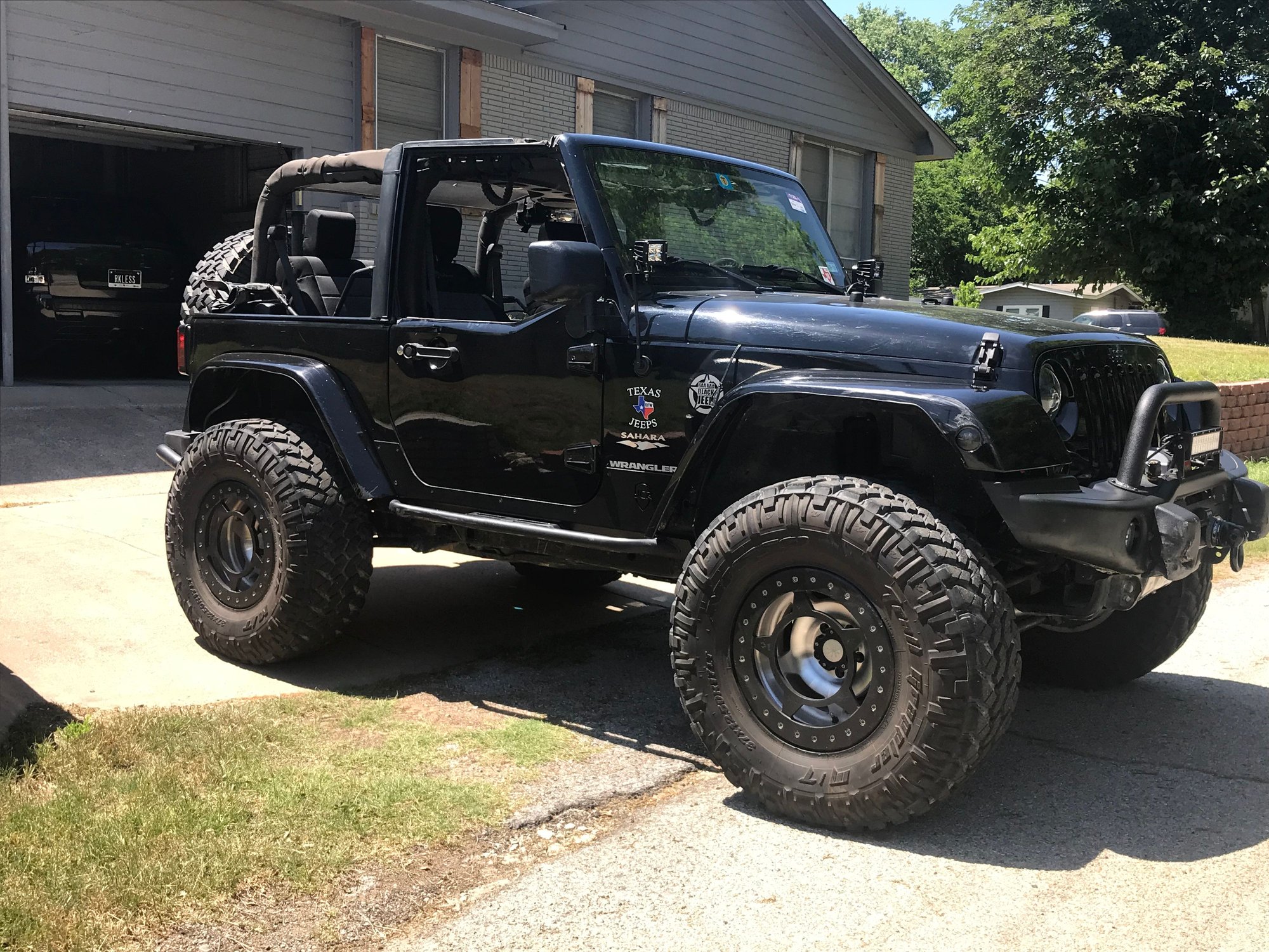

I've been running the Rock Krawler 2.5 X-Factor for over 4 years on my Jeep with Nitto Trail Grappler 35's and 2" bumpstops. I've got front and rear AEV bumpers with a 10k Warn Zeon 10S, JCR rock sliders, added RockHard 4X4's engine/tranny and transfer case skids a few months ago. I was still running the factory flares with it and never had any rubbing issues. I just jumped up to 37" trail Grapplers and Spyderlock beadlocks. I trimmed my factory flares, removed the rear inner wheel liners, and trimmed the front AEV bumper. No rubbing on the RTI ramp, but we'll see how it does once I get a chance to get it in the rocks. Still running the same 2" bumpstops.
