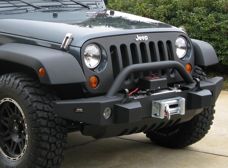

I have a Warn M8000 on my Mopar bumper. Easy install and did not have to remove the bumper.
Name:	IMG_2268 - Copy.jpg
