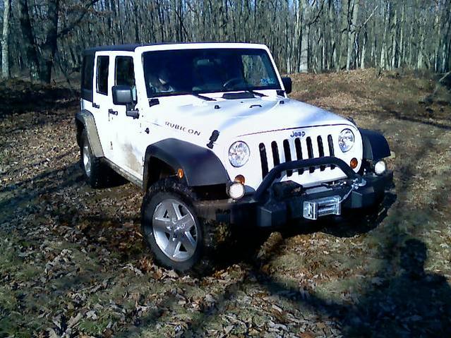

I have an XRC-8 from Smittybilt that fit perfectly without having to modify or do anything to the bumper. In fact, I was able to install it with the bumper attached to the jeep.

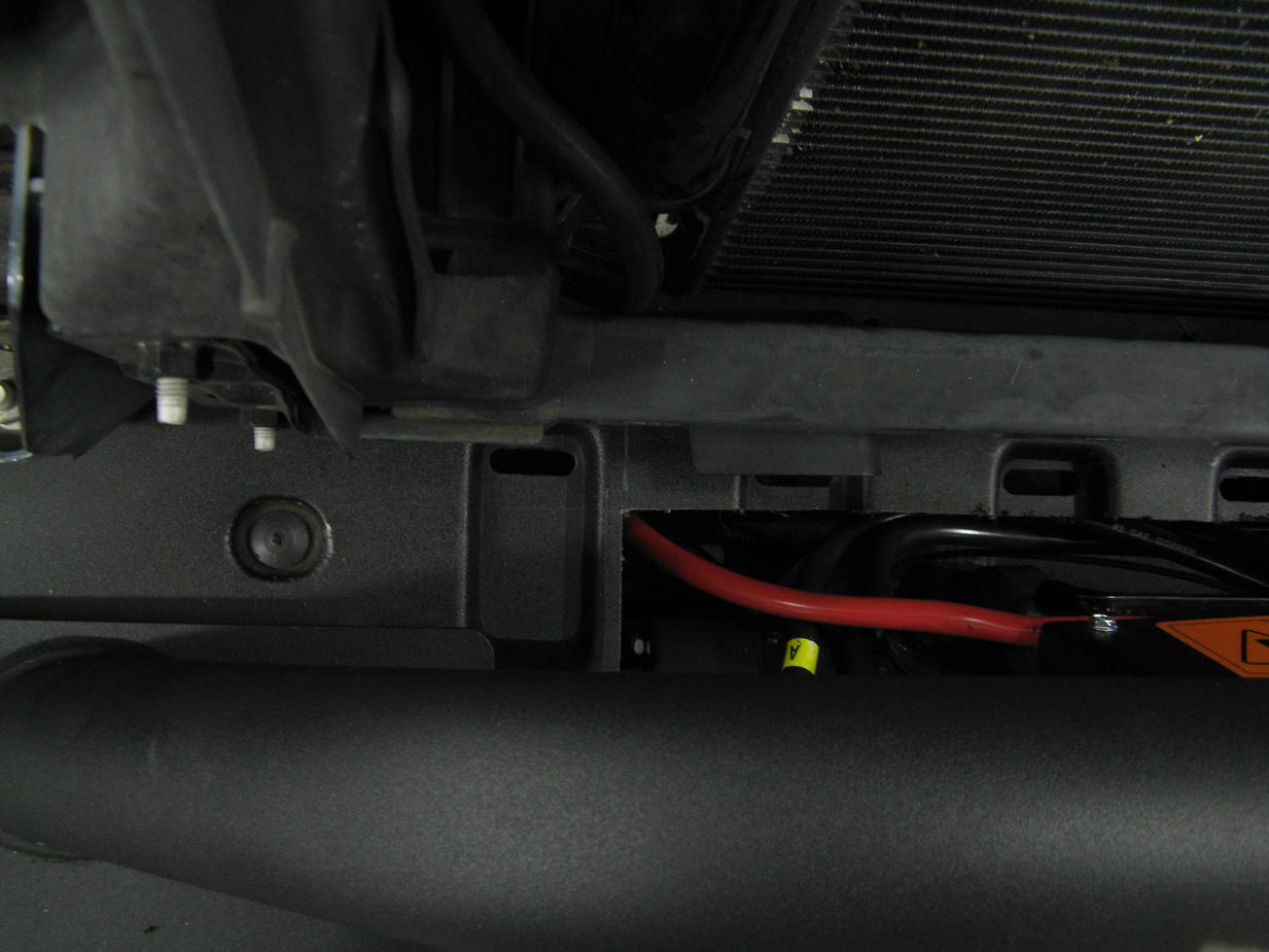

I did use the Warn bracket. I then cut the original plastic "bumper to grill space cover" to go around the winch and then ran the wires under the cover and grill over the top of the sway bar and up the radiator support area on the inside of the engine compartment. There is plenty of wire on the winch to do this and it eliminates the possibility of rubbing the grill paint or making any sharp turns anywhere else that may lead to rubbing of the leads. I will try to add a photo prior to putting the grill back on.
Huh... Never though of putting that back on. I'll have to go look and see about that.
