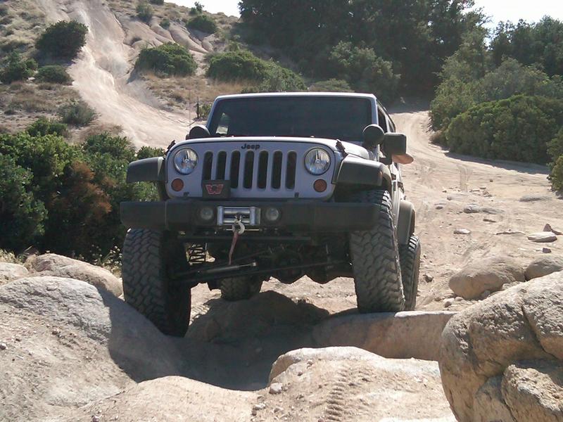

nvertflyer's Avatar
Posts: 357
From: torrance ca
ID:	335664 this was my warn m9000 set up before i fabbed my aluminum j8 bumpers...my new bumper set up uses the same inverted configuration as in this pic...as for how it works,i have used it at least 10 times pulling some of my buddies out of some pretty technical recoveries
Old Jun 30, 2012 | 07:18 PM
RoysRig's Avatar
Posts: 1,476
From: Mile High Colorado
Originally Posted by nvertflyer
Attachment 335664 this was my warn m9000 set up before i fabbed my aluminum j8 bumpers...my new bumper set up uses the same inverted configuration as in this pic...as for how it works,i have used it at least 10 times pulling some of my buddies out of some pretty technical recoveries
Okay, so the solenoid is still on top, that helps with the remote, but what about the other questions?

Old Jun 30, 2012 | 07:39 PM
nvertflyer's Avatar
Posts: 357
From: torrance ca
mine was a 2 wheel drive conversion so i didn't have the electric motor...the clutch is located on top of the winch therefore mounted inverted puts it in easy reach,and the spool is easy to see...i have really put this set up to the test...trust me it works well...at least mine does
