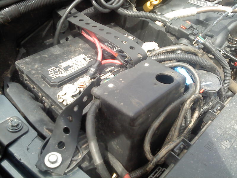

Old Aug 12, 2012 | 04:59 PM
RJtx's Avatar
Posts: 76
From: Tumwater, Wa
here ya go man aint pretty but its a work in progress
