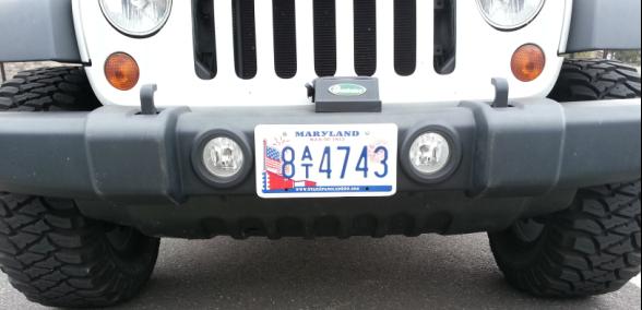

Few pics of mine. I used the Q9000 Winch from Quadratech with a universal winch plate from Harbor Freight. Also used the OR‑FAB relocation kit for my vacuum pump.
Here are some with and without the plastic bumper. I have tons of pics, let me know I can send them over.
