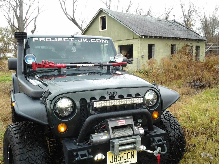

I run a Warn XD9000i.... Heavy duty battery
My dad has an "el cheapo" robo winch from ebay for 300 and it works GREAT!
Everyone will tell u "i have the best winch" its really which one u really want.... There's so may good brands out there to choose from that u can't go wrong!

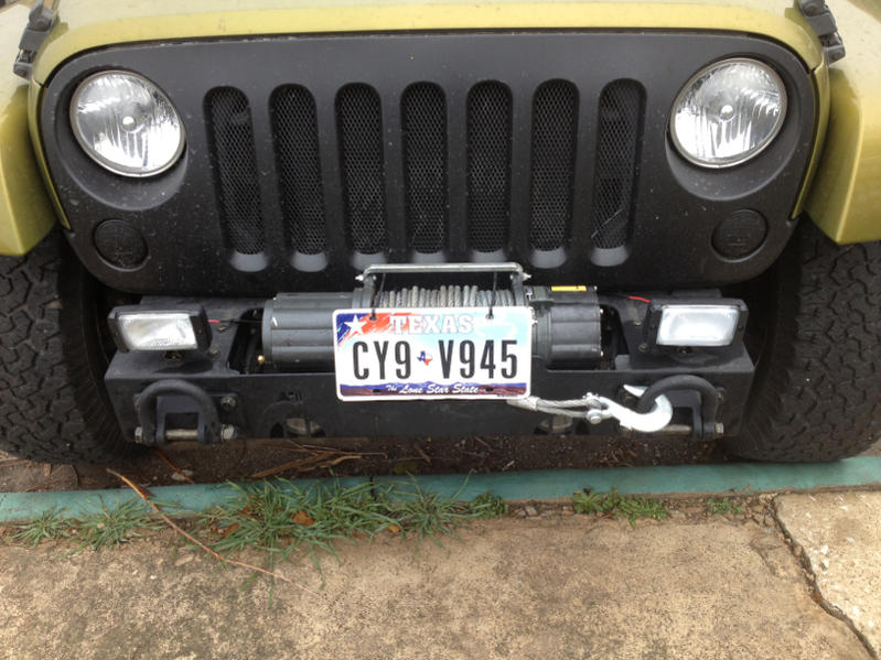

I've got a 10,000 lb Road Shock winch which is from Harbor Freight. I paid $100 for it on CL, just had to find some wires and buy a fairlead for it.
My cheap winch has worked great for me and my Jeep.
