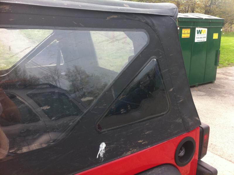

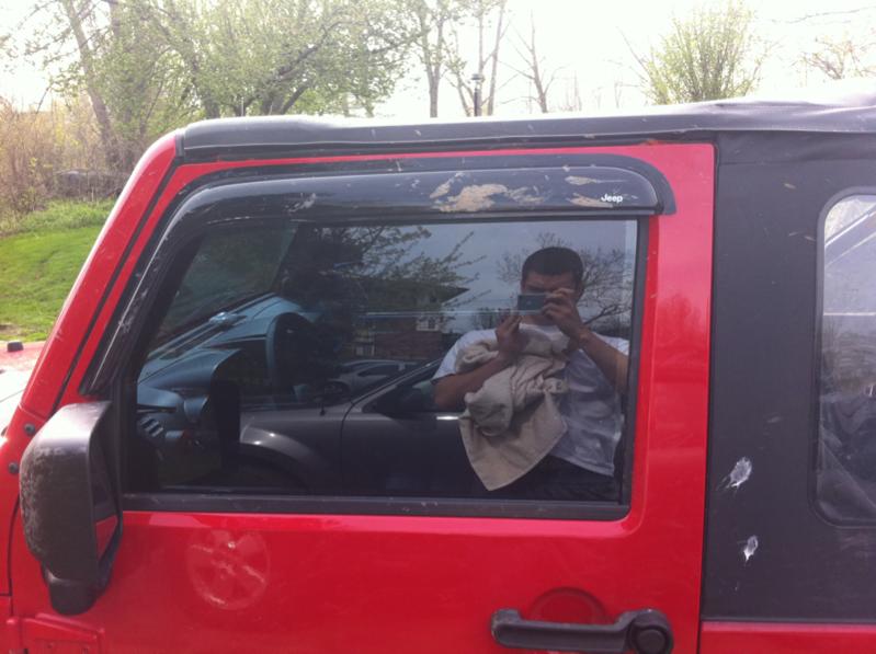

Here's what I've done so far. Not mind blowing, but for 9.99 and some time, it sure beats giving up a ton of bones. Especially when I'm satisfied with it.

Pretty sure 50% on the fronts is the legal limit everywhere, I wanted contrast between back and front so I at least look like I'm trying to comply. I opted for 30% and I like it a lot.

How are you doing the rear soft Windows? Film or some other way?

Yeah what are you using??? That was the whole reason i started this thread up again! I think it can be done

Yes I'm using film. I just picked up a roll of the Gila stuff that includes adhesive from Autzone and I haven't had any problems. I unzipped the windows and brought them inside to do the job.
Make sure to use a spray bottle with warm water and a bit of dish soap if you decide to apply it yourself. Otherwise you won't be able to adjust the film once you place it on the window.
Thank you very much!!! I was thinking of doing it myself, and the tips are noted and double noted. I already have all the windows out as it is because in CO it is beautiful right now. I think i will have this done by Tuesday at the latest.
Any problems with bubbles or imperfections? The rear soft window is the only one Im worried about making some errors

I'm just happy I could help a little
Honestly, I'm a little nervous about the rear back window, especially since mine doesn't come out all the way :/
However, the side ones were nice because I could bring them inside and really make sure they were cleaned good. Just be careful when you're cutting the film to fit that you don't cut through your window the soft top windows thus far have actually been easier than my two regular side windows up front. But thats just my opinion. I haven't seen any bubbling yet. It rained last night and it's been sunny all day today plus I had all the windows up (new tint, not supposed to roll them down) and even after that none yet. The Gila film really sticks well if you treat it right.
Let me know how it goes and ask me any questions, whenever.
