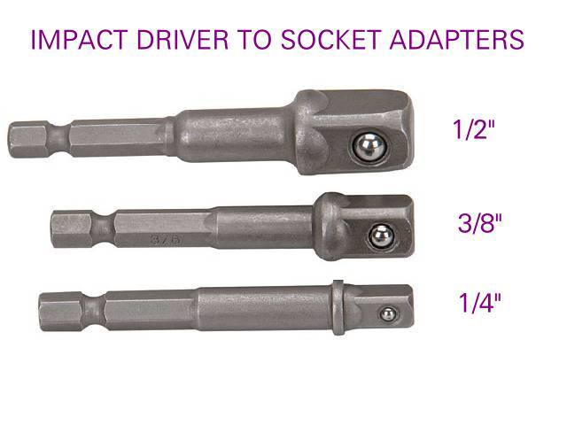

So I have an impact driver (uses hex bit attachments) and would like to know if anyone has found any bits that go directly to sizes to say 21mm. I've broken too many of the 1/2 socket adapters and Home Depot is on to me now.
I have been using these but they snap at the thin part.

I have two battery powered impact drivers. The one that takes the adapters like in your picture isn't strong enough to brake anything socket relater. It's more for driving screws, the impact effect giving it a little more power than a regular drill/driver.

while those small impact drivers are handy 21 mm is to big for that sizeof driver, you should be looking at least a 1/2" drive.

There are multiple 1/2" cordless guns under 300 that will do everything you need.
A 1/4" inch lbs. gun with a half inch shank adapter is not the right tool for the job.
