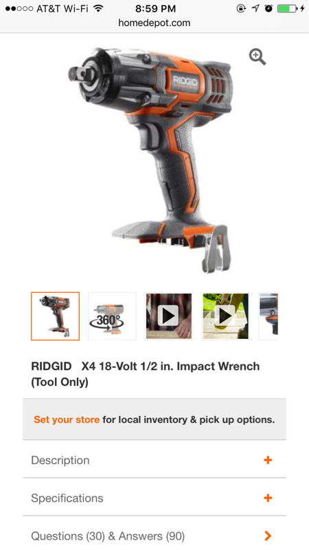

I ended up buying a rigid 1/2 impact wrench.
Hopefully this is all that is need about 375 ft lbs the guy said.
