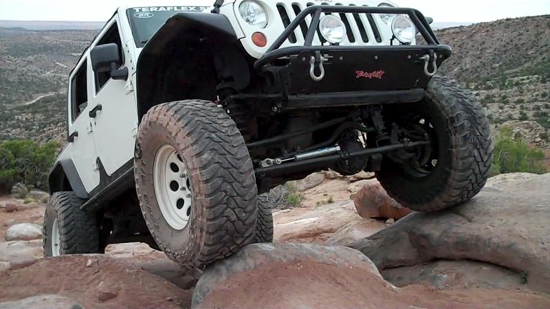

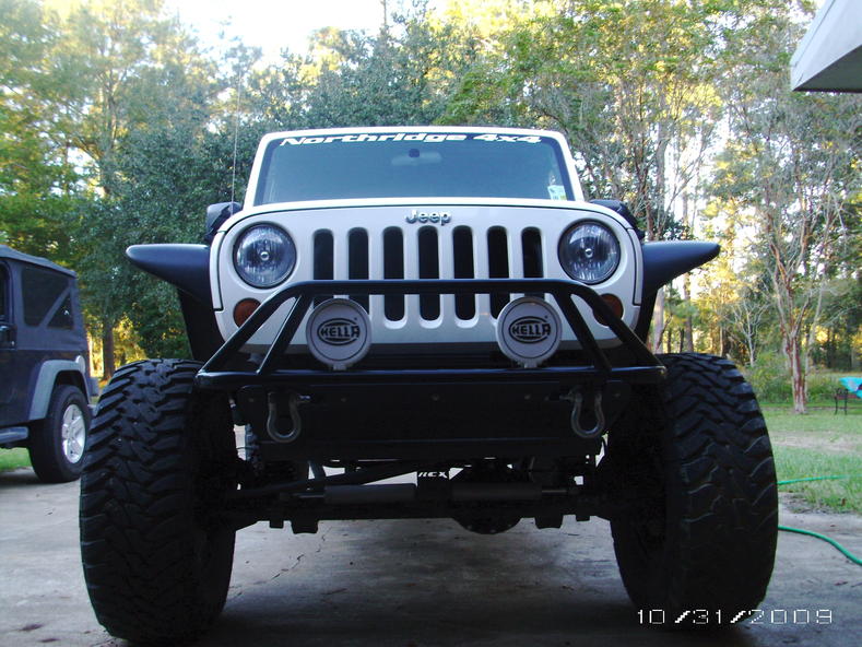

stock
flipped
I think they come with a bend.
